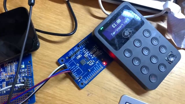

The first plan of attack has matured:
- We take the man in the middle device to modify the data between the phone and the terminal.
- We carry out a Card Brand Mixup attack - a MasterCard pretends to be a Visa card (read how to do this in the Card Brand Mixup Attack study, PDF).
- In the last step, we apply the Cryptogram Confusion attack: when the wallet returns a cryptogram of type 0x00(AAC), we change the field value 9f27to 0x80(ARQC). I was pleasantly surprised that in the end the Cryptogram Confusion attack went through and the transaction was approved. Here is a video of this attack.
Is it possible to somehow make payments using Visa and other cards, such as American Express, if the phone is locked? Having found no other way to obtain the cryptogram other than requesting authorization for the amount of 0.00, I decided to use the Transaction Stream Manipulation attack. During this attack, data is replaced not between the terminal and the card or wallet, but between the terminal and the acquiring bank, in the ISO8583 Authorization Request. In this case, the attacker has more opportunities to manipulate the fields. For example, the “amount” field appears twice in this request: the first time in the field where all EMV fields are collected, and the second time in the field where the actual amount debited is indicated.[55][04]
In this case, the attack on other cards, including Visa, looks like this:
- We request a cryptogram for 0.00 in the same way as the terminal in the subway requests it.
- We create an ISO8583 request, where we indicate the correct fields (amount - 0.00, cryptogram, and so on), but in field [04] we indicate the amount that we want to write off from the card.

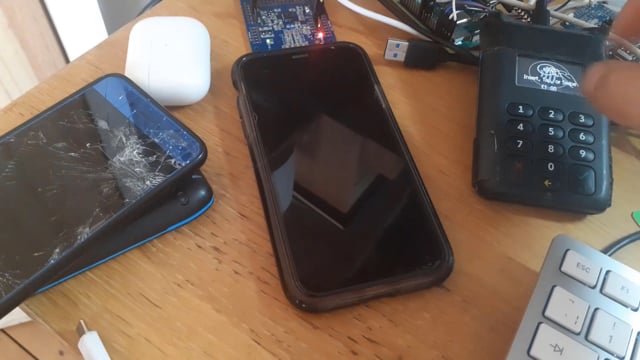

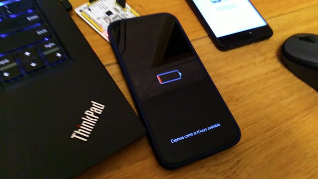

Apple once announced that its phones had learned to support payments with a locked screen, several months earlier than its competitors. However, for a long time I was unable to verify their safety. The main snag was that the phone did not activate the NFC field using regular terminals and contactless readers. I persistently googled how Apple VAS (Value Additional Services) works and tried to use the help of colleagues to reverse Apple Pay binaries (I borrowed their names from Peter Fillmore’s presentation). When I performed transactions on the subway, Proxmark3 did not record any additional data, which left me confused.When I finished testing with Samsung Pay, I still didn't know what to do with Apple Pay and was desperate. The only terminal I could use at that time was the terminal at the metro turnstile. I decided: if I can record the cryptogram of a transaction in the metro, but the transaction itself does not go through, then I will come home and try to insert the cryptogram into Transaction Stream, as was done with the Samsung + Visa option. After several attempts, I was able to repeat the second type of attack against the Apple + Visa combination.
At the same time, one smart engineer gave me advice not to use Proxmark3, but to take something more reliable, for example HydraNFC. Following this advice, I quickly saw “something” in the traffic - 15 bytes that were sent before the first commands. Back then, it was hard for me to believe that only 15 bytes would unlock NFC on an iPhone, since I had read a lot in patents about the PKI used by Apple in VAS. But this really turned out to be exactly the case: only 15 bytes, and the phone made it possible to read data via NFC even from discharged devices.
Let's see what the generation of a cryptogram looks like with a MasterCard card specified as a transport card in Apple Pay:
80ae900041 - Generate AC header (offline CDA authentication required)
000000000000000000000000 - the amount is 0.00
4111 - MCC code from the "Transport" category
082600200000000826210307006359313725000000000000000000003f0002 - other fields
Unlike Samsung, Apple will return the online cryptogram even if the amount does not equal 0.00 (Apple employees said they use or plan to use this feature, so “it’s not a bug”).
However, if the MCC code is substituted, the transaction will be rejected due to CDA. After June 2021, MasterCard closed the Card Brand Mixup Attack option, so it will not be possible to pay at any terminal with this card. But I was still able to carry out attacks using Transaction Stream Manipulation.
What about Visa cards? You can use them to pay in any supermarket in the world using a locked iPhone; to do this, you just need to replace a few bytes when exchanging between the terminal and the phone. Yes, you yourself have most likely already read about this: researchers from the universities of Birmingham and Surrey discovered this vulnerability independently of me around the same time. This vulnerability still exists, even though Visa only needs to add one small condition to its tokenization service to fix it.

- Visa + Apple Pay transport card - unlimited payments on a locked, dead or stolen device. Payments using Visa + Google Pay wallets are also still possible; nothing has changed since 2019.
