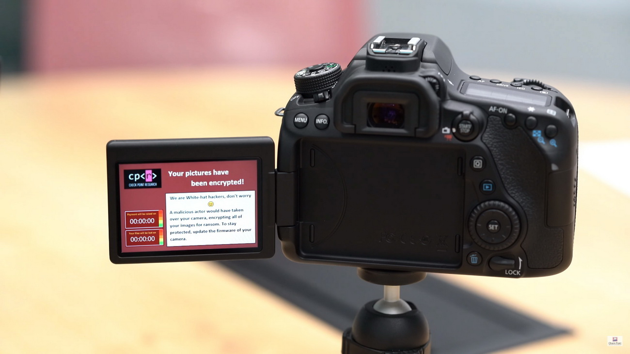

Check Point analysts have discovered six vulnerabilities in the implementation of the Picture Transfer Protocol (PTP) used in Canon cameras. The exploitation of these problems ultimately leads to seizure of control over the device and allows the attacker to install any malware on the DSLR (including "over the air" if the camera supports wireless connections). Researchers demonstrated such an attack using the example of a Canon EOS 80D SLR camera, which was eventually infected with a ransomware over Wi-Fi connection.

Such a firmware update will have all the correct signatures, and the camera will take it as legitimate. As a result, the experts were not only able to create an exploit that works both via USB and Wi-Fi, but also discovered a way to encrypt files on the camera's memory card. For this, the same cryptographic functions were used that were used for the firmware update process. The video below demonstrates an attack on a Canon EOS 80D via Wi-Fi and a ransomware infection of the camera.
