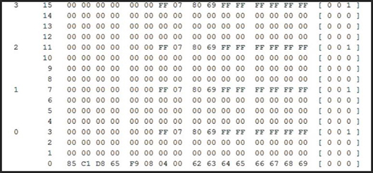

First, we'll load dumpinfo and look at the content of the cards.
We will consider sectors from 0 to 3.
Clean Card
Card with information
