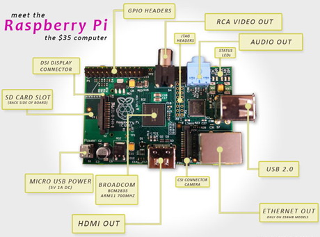

So, what are we talking about? Raspberry Pi is a small, two matchbox-sized, cheap single-board computer with an ARM processor (Advanced RISC Machine, RISC means reduced instruction set computer, well, you get the idea, :)cheap and cheerful, with a simplified set of commands). It is produced by British scientists, the British company Raspberry Pi Foundation, since 2012 and to this day. The first models were completely wooden, with a clock frequency of a 32-bit single-core ARM 11 processor of about 700 MHz and RAM 256 or 512 MB; now models with 64-bit 4-core processors with a clock frequency of 1.5 and even 1.8 GHz are already available. The product is also equipped with USB ports in the amount of 1 to 4, a coaxial antenna input, a TRS 3.5 mm audio input/output, an Ethernet port, Wi-Fi on older models is provided via a USB dongle, and on newer ones it is built-in; there is also an HDMI port for connecting a monitor and other devices and a slot for an SD memory card, which stores the file system, kernel and user files; new models may also have built-in Bluetooth. All this works under Linux/FreeBSD operating systems; Raspbian (a special build of Debian) and Pidora (a special build of Fedora, Lieutenant Rzhevsky, shut up, this is not what you just thought!) with a lightweight LXDE graphical interface are quite common. People also use ArchLinux, Gentoo, FreeBSD, Sailfish OS; it is possible to use Android 7.0 and even Windows 10 IOT (I really want to say “idiot”, because it is utter idiocy IMHO to push Windows into Raspberry, it’s like loading a small donkey with a sack of bad proprietary sand-lime bricks, but wouldn’t that lousy Bill Gay (shh!) have stuck his long nose in here too and vulgarized everything, just like he did with Skype, buying it from a Luxembourg company in 2012).

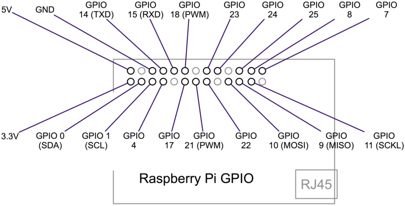

So what, you say, so small, so cheap (35 Baku somewhere), so what? The biggest advantage of the said device IMHO is the presence of a GPIO (general purpose input/output) interface of 26 pins (on more modern models as many as 40!), which opens up a wide field of possibilities for controlling all sorts of peripherals. The normal voltage on the pins is 5 and, accordingly, 3.3 V; do not supply more - you can burn the pins! So, we have, among other things, 2 pins with a constant voltage level of 5 V, 2 pins with a constant voltage level of 3.3 V, 5 common pins (ground), 17 digital software-controlled pins. I give the pinout options for 26 pins below.

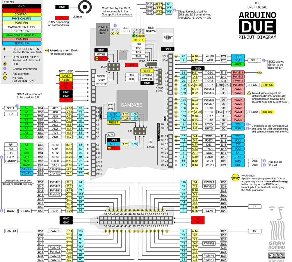

Now let's pay tribute to the notorious Arduino. It is a family of microcontrollers produced by a company from Ivrea, Italy, near Turin, and named after a local beer/bar (where the locals actually invented the giulico bandito while drinking), which in turn was named after the local medieval king Arduino the XII. It (the microcontroller) comes with software in the form of an IDE development environment and a C-like programming language, or more precisely, C++ with the Wiring framework. The scripts for working in it are called sketches by the manufacturer. And here is an illustration of the Arduino Due pinout.
You can do the same things in them as in Raspberry, that is, control various hardware via pinout and with the help of scripts-sketches loaded from a computer via a USB port. At the same time, Arduino shields can be paired with each other like a sandwich, putting one on top of the other. And the LED in Arduino blinks something like this.

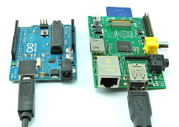

Now, what is the difference between Arduino and Raspberry. Raspberry is almost an honest computer, and Arduino is just a microprocessor, its capabilities are more, how to put it softly, somewhat limited. Critics of Raspberry will say that it works “not in real time”, that is, it is slow at times, so install a microkernel RISC OS or RTLinux on it and you will have real time, the ARM processor is initially sharpened for this. Is it possible to combine these two products in one product - of course it is possible, but is it necessary?
