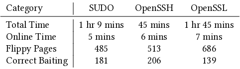

Researchers from Worcester Polytechnic Institute (USA) have introduced a new type of Mayhem attack that uses the Rowhammer dynamic random access memory bit distortion technique to change the values of stack variables used as flags in the program to decide whether authentication and security checks have passed. Practical examples of the attack are demonstrated to bypass authentication in SUDO, OpenSSH and MySQL, as well as to change the result of security-related checks in the OpenSSL library.

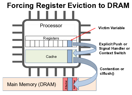

The attack can also be applied to comparisons of the form “if(auth == 1)”, but in this case its implementation becomes more complicated, since it is necessary to distort not any bit of 32, but the last bit. The method can also be used to influence the values of variables in processor registers, since the contents of the registers can be temporarily flushed onto the stack when a context switch, function call, or signal handler fires. During the period of time while register values are in memory, distortions can be introduced into this memory and the changed value will be restored to the register.
To distort the bits, one of the modifications of the RowHammer class attack is used. Since DRAM memory is a two-dimensional array of cells, each consisting of a capacitor and a transistor, performing continuous reads of the same memory region results in voltage fluctuations and anomalies that cause a small loss of charge in neighboring cells. If the reading intensity is high, then the neighboring cell may lose a sufficiently large amount of charge and the next regeneration cycle will not have time to restore its original state, which will lead to a change in the value of the data stored in the cell. To protect against RowHammer, chip manufacturers have added a TRR (Target Row Refresh) mechanism, which blocks cell corruption in special cases, but does not protect against all possible attack variations.
