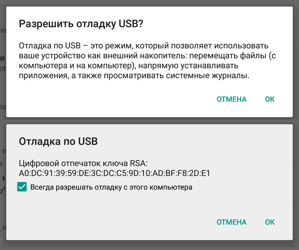

We need: a high-quality cable, USB ports directly from the motherboard (to minimize the possibility of getting a "brick" from the device), access to the developer menu and the device itself with a computer. The developer menu is usually opened with a few taps on the build number in the device information menu. There we enable USB debugging. A pop-up window will appear with permission to debug - we agree.
USB debugging permission

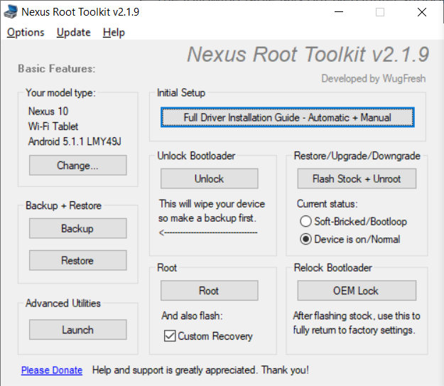

To unlock, I used a special program Nexus Root Toolkit, where everything happens with a few clicks.
1. Launch the program. If everything is installed correctly, then our device will appear in the log window. It is worth paying attention to its code name - "manta". It will be useful to us. Other devices can be codenamed on the Internet.
2. Press the “Unlock Bootloader - Unlock” button, this will delete all data on the device.
The program log will inform us about the successful unlocking and reboot the device.
3. The next step is to get root and immediately install custom recovery (I installed TWRP 3.0.2). Put a check mark on “Custom Recovery” and press the “Root” button. The program will give us a link to the latest version of TWRP, go, download and specify the path in the program to the image file “twrp * .img”.
Supersu and BusyBox are installed along with root. If not installed, you can download them from the Play Market. Next, manually install the BusyBox package through the appropriate application. BusyBox will ask for root rights - we will definitely agree!
Install BusyBox *

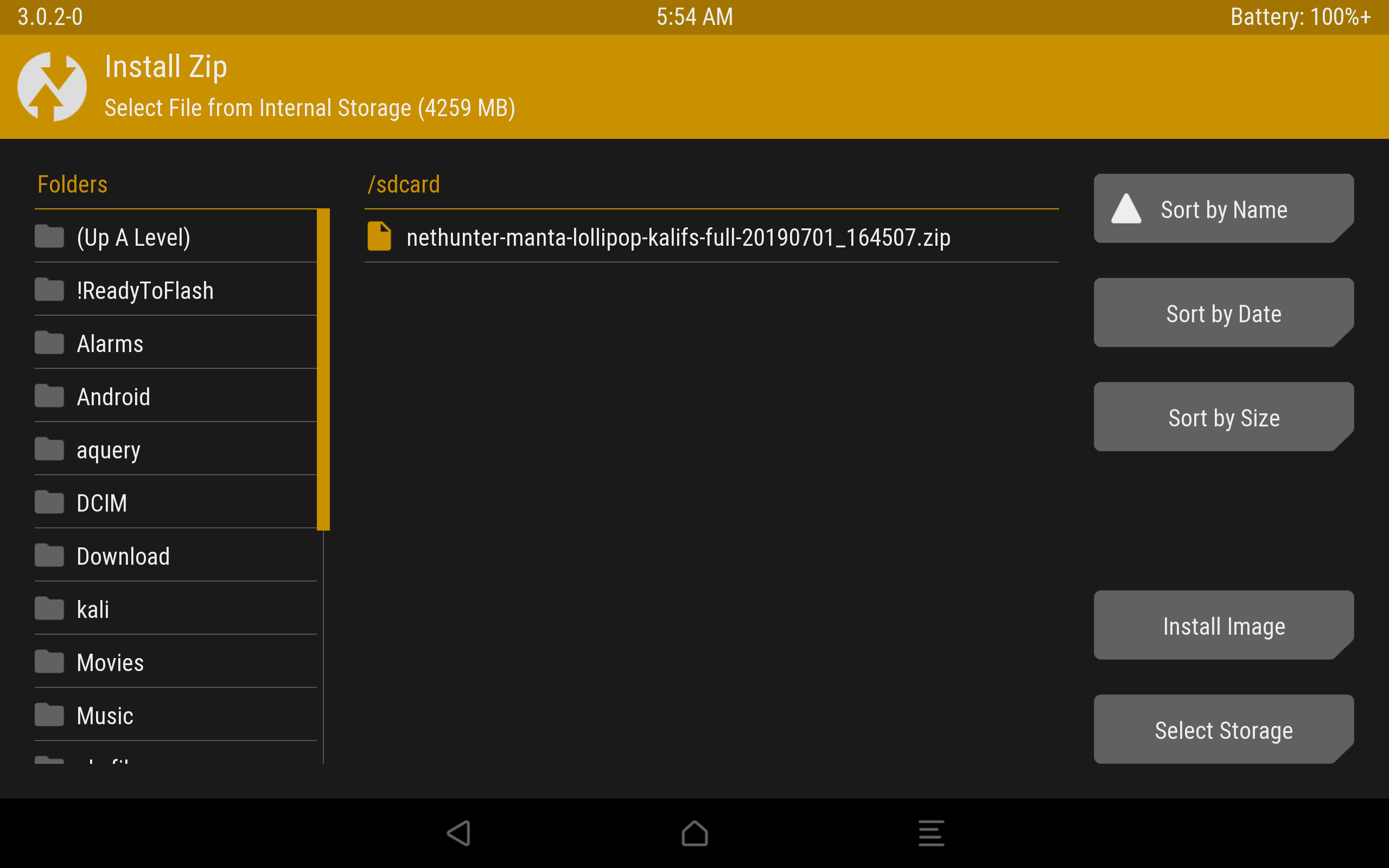

Installation process via TWRP.
Android will load and optimization of applications will start. As a result, the wallpaper changed, several new programs appeared in the menu, which, unfortunately, were not installed correctly.
Incorrectly installed programs.
It's easy to fix: unpack the zip archive and install applications manually via apk files that are in the * unpacked zip archive * / data / app. Before that, you should enable the ability to install applications from unknown sources. Now we install first nethunter.apk, and then all other applications. We reboot the device and see that the icons started to display normally. I advise you to additionally configure HackerKeyboard, since it is more adapted to work with the terminal.
