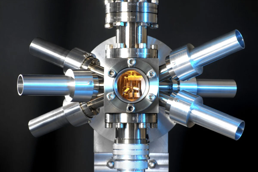

Scientists from China have created a unique optical clock that is so accurate that the error in its course is only one second in 7 billion years. Described in the scientific journal Metrologia, the achievement paves the way for a revision of the definition of the second as the main unit of time measurement.
Researchers from the University of Science and Technology of China used super-cold strontium atoms and high-power laser beams to create a clock with a stability level and an error of less than five quintillionths. Thus, China became the second country after the United States to achieve such time accuracy.
Optical clock based on strontium.

In their work, a group of Chinese scientists cooled strontium-87 atoms to a temperature of several micro-Kelvin and placed them in a one-dimensional lattice created using intersecting laser beams. Then they used a super-stable laser to interact with trapped strontium-87 atoms and initiate a so-called clock transition, which is characterized by high stability and accuracy.
The scientists also performed frequency measurements between two independent clocks, which demonstrated that the stability of individual clocks is on the order of 2.2 quintillion. The total uncertainty of the system as a whole was 4.4 quintillionths, which is equivalent to a deviation of one second every 7.2 billion years, the authors concluded.
