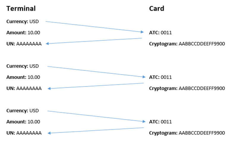

Cryptogram Replay. If the compromised terminal issues the same field UN, once read from the card, the cryptogram with the transmitted predictable field UNcan be used as many times as desired. Even the next day, attackers can transmit information about the old cryptogram with the old date in the authorization request, and this will not lead to denial. In my tests last year, I repeated the same cryptogram seven times over seven days, and this did not raise any suspicion from the bank.
Cryptogram Replay Attack Scheme
Cryptogram Preplay. This scheme is used if the vulnerable terminal does not return the same UN, but gives them predictable ones. This is how the vulnerable ATM worked in the Maltese attack described above. In this case, the attacker, when physically accessing the card, clones several transactions "for the future." Unlike the first attack, each transaction can only be used once.
